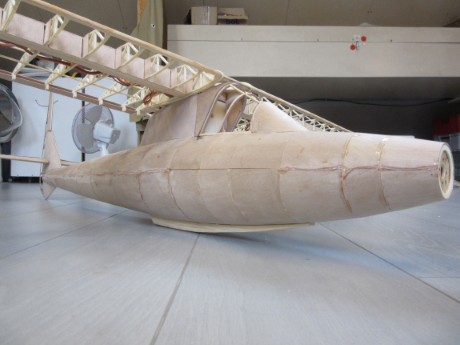

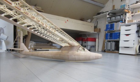

What I always find difficult with building is that one thing has to be done first, and then another, and sometimes that's a puzzle.
To make the skeg, I had to sheet the fuselage, but I also had to make the control rods. With the the control rods, I couldn’t replace the fuselage on the building jig…… So first the sheeting the bottom, then the skeg and the control cables later.
So first, the skeg, had to take some pieces of the frames away
The advantage of building on a horizontal jig is that the fuselage can be put on and taken off. To sheet the tail (the nose is already dimensionally stable due to its internal structure), I slid the fuselage back onto the jig. The fuselage rests stable there, and now I can sheet the bottom. After fitting a piece of 0.6mm plywood to size, I scarfed the edges
The rear end of the tail was quite narrow, I bent the rear pieces under boiling water and let them dry rolled up, put a rubber band around it and let it dry
How far you can bend it; see https://youtu.be/KoZUbuMlBck.
I glued the plywood with PVA and because the fuselage is open at the top I could clamp it to the stringers
Skeg construction
Then the servos were installed and the Bowden control rods aligned checking if everything moved well.
Because the airfoil will be 13% instead of 9% (this will be explained during the construction of the wing), the "neck" had to be shorter; it was actually quite long. It should be 15 mm shorter. I cut the top 30mm off, bevelled both sides, and glued back in with thickened epoxy
It looks more proportionate this way.
I also sheeted the removable cockpit parts and made the recesses for the pilot's shoulders!
Now I go on sheeting the fuselage with ply.

Bonjour a tous,
Now I had to sheet the upper half. I found that quite difficult, especially applying pressure on the glue. Finally, with a few drops of cyano, I glued 3 X 3 slats onto a prepared panel
I spread PVA on the stringers and frames, except for the horizontal stringer where the bottom panel was already glued to. There I put cyano on the edge of the panel. This way I could press it nicely in place
until the cyano was set. It then looks like this
I cut off the slats later. I did the entire fuselage in the same way.
Unfortunately, I couldn't get it super smooth, that had to be sanded, I wasn't very happy with that. Fortunately, all the wood is painted, not clear varnished, that gives me a lot more freedom, but still....
Fortunately, it does feel light.

MessagePosté le: 09/01/2026 12:33    Sujet du message: Répondre en citant
Hi Vincent,
You're making great progress !
Handling cyanoacrylate without latex gloves... care your fingers Laughing
I've never tried it... but the technique of reactivating white glue with an iron seems obvious to those who have practised it.
Looking forward to seeing your progress !

Hello Sebastian,
Yes I tried the "PVA ironing" method on my King Kite, it works well (with thin ply). But I guess I was in the cyano glueing mood Laughing
It surely was a remarkable glider !

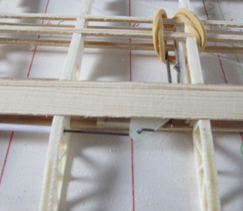

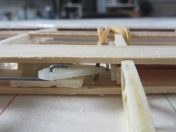

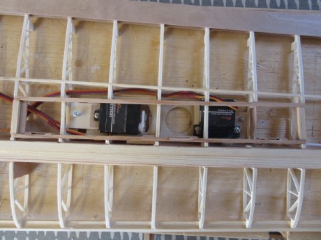

Because there was not enough space for the aileron servo at the location of the aileron, it had to be moved closer to the wing root. I decided to place it under the aperture of the spoiler together with the servo of the spoiler. With some fiddling I could change them without making extra holes in the wing.
A 0.8mm steel wire goes to a rocker arm (bellcrank) at the aileron control
. To get that play-free I drill a 0.5 hole in the epoxy and ream it with a 5-sided reamer until the steel wire just fits., I also do that with the (not visible) 2mm axle (nail). Same tool to fit the 0.8mm fit in the servo arm
The spoiler frame glued in
Details of the root rib; the servo connector and hook for the locking elastic band . Because the middle part is detachable, I could fit it without a fuselage
Now I was able to assemble the Hjordis for the first time, unfortunately because of the weather inside.
it's starting to look like a sailplane!
