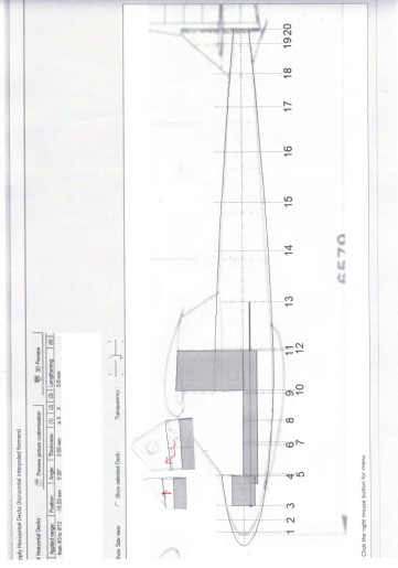

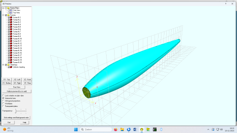

I started drawing the fuselage, with Devfus, based on the existing drawings. I couldn't get the nose to match the photos. In the photos, the nose looked more pointed than in the drawing, so I decided to make the nose a little more pointed, which also meant that the e-drive with spinner would fit. A little bit of cheeting is allowed now and then.....
A three-dimensional image of the fuselage gives a good impression and, no, it's not a submarine! The internal reinforcements for the pylon, battery and removable cockpit can also be seen here.

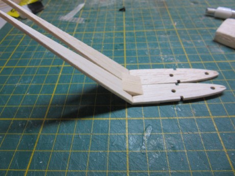

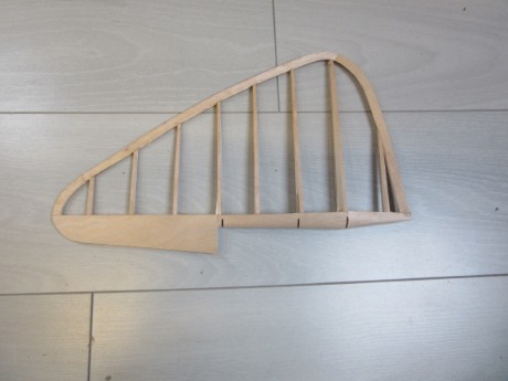

The stabilizer moves entirely on two pins. I still had some thin-walled 3 mm stainless steel tubing, which I'll use as a holder for the two "wing" joiners : the rear one as a pivot point and the front one to adjust the stabilizer.

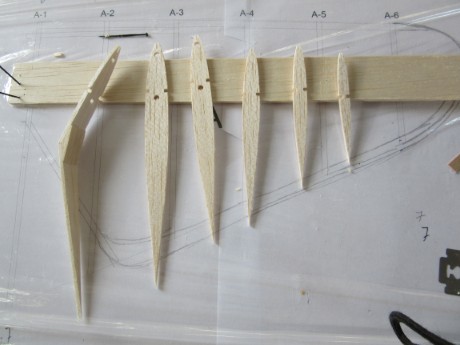

I chose the HQ-10 symmetrical profile, and Adri milled beautiful balsa ribs
I immediately applied Maarten's tip for the LE (from the Dutch forum). The TE is constructed of 0.6 mm plywood top and bottom, with a 1 mm spruce strip between them at the front, which is quite sturdy. The ribs are quite fragile, but that's improved after gluing on cap strips. The tips have a balsa core, then covered with plywood. I can sand without any worries, because this plane is painted, not clear-coated.
The stabilizer still needs some finishing, but I'm going to make the vertical stabilizer first.

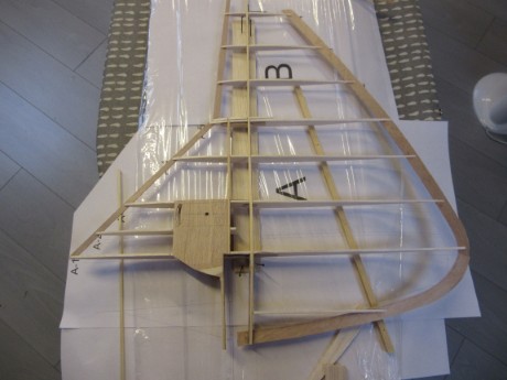

The vertical stabilizer consists of a small fin that extends under the fuselage into the tailskid. The top section houses the mounting and controls for the stabilizer.
I tried to draw it in Devwing
I adjusted the thickness of the HQ symmetrical profile so it could be properly positioned in the tailboom.
I also drew only the 1mm holes for the continuous hinge pin in the ribs, not the semicircle that should be used for a round leading edge. This resulted in too many loose parts, and I couldn't find anything in the program to solve that.
I made the base on a modified building board.

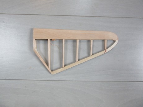

I made the tip and D-box of the rudder in the same way as I did for the stabilizer.
Then I glued 1.0mm plywood reinforcement plates to the ribs to form the hinges.

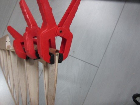

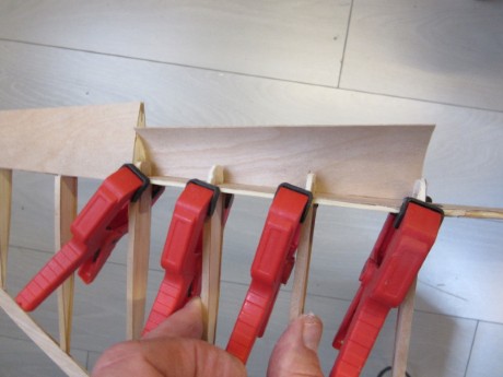

Now I could cut the rudder loose and make the round the nose. I bent plywood around a round pipe with boiling water to make the it. I first glued that to one side with cyano
and once that was hard, the other side.
I did the very tapered bottom part separately with
Then I cut slots for the hinges and fittings.

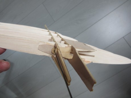

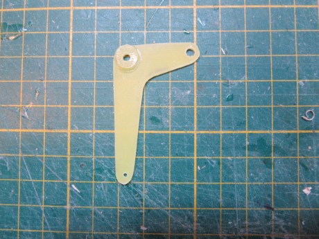

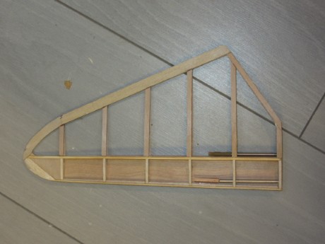

Before I sheeted the fin, I made the elevator lever. I sawed it from 1.5mm epoxy sheet, but unfortunately, I had to modify it to allow for 10 degrees of up and down travel. Here's a picture of the botched version. I used the thin walled 3mm stainless steel tube as a hinge for the lever.

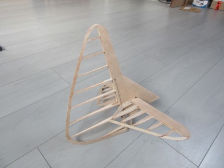

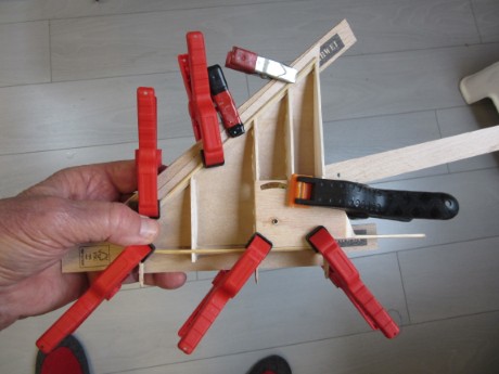

Now I could cover it, using lots of clamps.

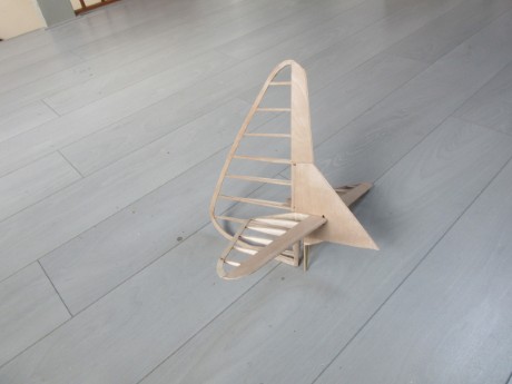

The tail surfaces completed
This whole thing weighs 115 grams

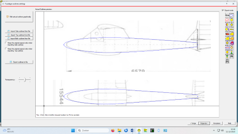

I drew the fuselage (some time ago already) using Devfus. I have already drawn a few fuselages with this programme, but this one was a bit different because of the pylon for the wing.
Back to the information about the original. In the drawings I could find, the Hjordis has a fairly blunt nose, but in the photos it looks much more pointed.
So when drawing it, I made it a little more pointed
It looks nice and sleek

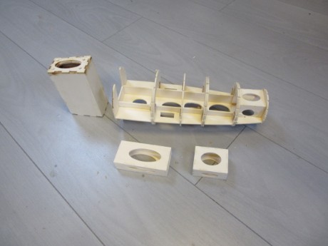

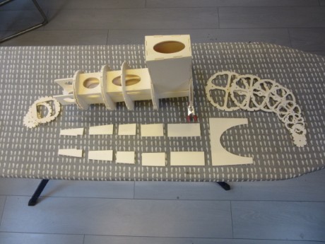

The cockpit of the Hjordis is very small, so I had to make a larger aperture. I drew the top of the battery box on the centre line and made the upper half of the fuselage removable. This had to be done in two pieces, as there was no other option due to the pylon. The front piece can then be removed straight upwards and the rear piece first forwards and then upwards. The motor can then be slid in through the battery box.
To be on the safe side, I drew two more boxes in the removable pieces to make them sturdy.

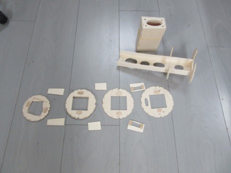

[133 420-001
Adri did some nice CNC work in poplar ply (obtained thanks to a very nice fellow modeller).

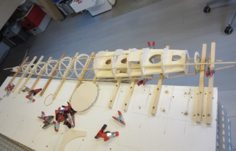

I cut the frames in half to make the top removable and temporarily glued them together with pieces of scrap wood.

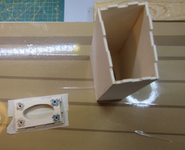

In the pylon, I thickened the plywood and inserted four insert nuts, to which the wing centre section will be attached with (nylon?) shear bolts.
Because the battery box also rests on the centerline, I was able to assemble it separately from the building frame. That went very smoothly, as did the holes for the servos and a small board under the battery box for the decoupling servo, so it must be able to be towed.
I had already made the building frame, a sturdy board with 10X10mm slats at right angles and at frame spacing.
I am leaving out the boxes for the removable fuselage halves for now, so that the whole thing fits on the slats of the building board.
I put in some stringers to see if everything fits, which fortunately was the case.
