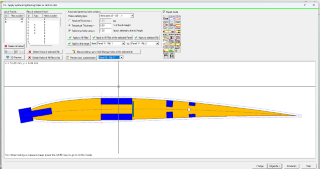

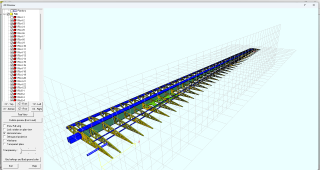

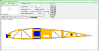

I was enjoying myself and decided to draw the wing as well, using Devwing.
For the airfoil I wanted to choose HQ 2.0-9 at the root to the aileron, then tapering to HQ1.0-1 towards the tip, in the hope of avoiding tip stall.
It would be nice if I could get a model that flies well in thermal, it is all flat over here, no slopes.

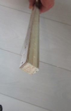

Since I was sitting at the computer anyway, I used Ecalc to calculate the main spar, 2 mm x 20 mm spruce upper and lower, which would give it a strength to withstand 14G.
I was also able to calculate the wing connector and opted for a rectangular tube that fits nicely into the spar, 12 mm high x 15 mm wide. Made of UD glass with epoxy, it should be able to handle 20G, which will not fail, I presume.

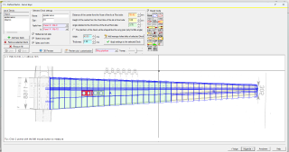

I drew the stabilizer in Devwing, making the D-box slightly wider,
I'll adjust the angled root rib manually.

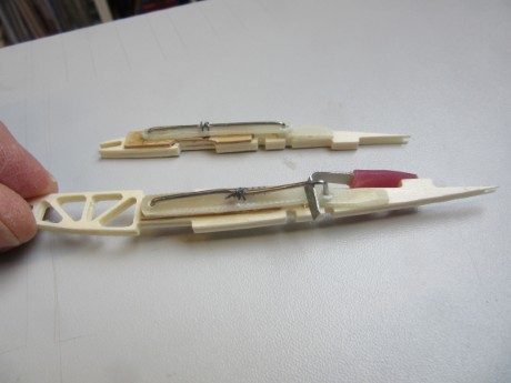

Before I sheeted the fin, I made the elevator lever. I sawed it from 1.5mm epoxy sheet, but unfortunately, I had to modify it to allow for 10 degrees of up and down travel. Here's a picture of the botched version. I used the thin walled 3mm stainless steel tube as a hinge for the lever.
Now I could cover it, using lots of clamps.

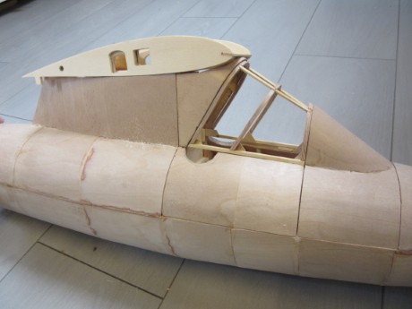

I went on with the fuselage
I drew the fuselage (some time ago already) using Devfus. I have already drawn a few fuselages with this programme, but this one was a bit different because of the pylon for the wing.
Back to the information about the original. In the drawings I could find, the Hjordis has a fairly blunt nose, but in the photos it looks much more pointed.
So when drawing it, I made it a little more pointed
It looks nice and sleek
The slightly more pointed nose also made it easier to install an engine, an outrunner with an extended neck (Hacker A30-8XL-LN). With a Z spinner, I hope the propeller blades will fit nicely.
The cockpit of the Hjordis is very small, so I had to make a larger aperture. I drew the top of the battery box on the centre line and made the upper half of the fuselage removable. This had to be done in two pieces, as there was no other option due to the pylon. The front piece can then be removed straight upwards and the rear piece first forwards and then upwards. The motor can then be slid in through the battery box.
To be on the safe side, I drew two more boxes in the removable pieces to make them sturdy.

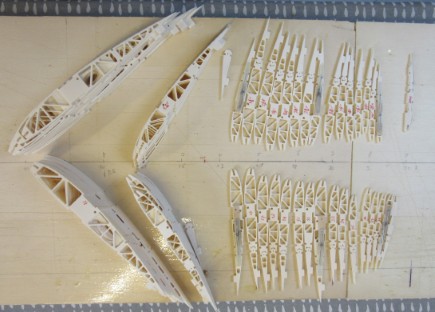

[133 420-001
Adri did some nice CNC work in poplar ply (obtained thanks to a very nice fellow modeller).
I cut the frames in half to make the top removable and temporarily glued them together with pieces of scrap wood.
In the pylon, I thickened the plywood and inserted four insert nuts, to which the wing centre section will be attached with (nylon?) shear bolts.

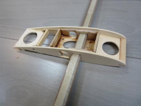

Because the battery box also rests on the centerline, I was able to assemble it separately from the building frame. That went very smoothly, as did the holes for the servos and a small board under the battery box for the decoupling servo, so it must be able to be towed.
I had already made the building frame, a sturdy board with 10X10mm slats at right angles and at frame spacing.
I am leaving out the boxes for the removable fuselage halves for now, so that the whole thing fits on the slats of the building board.
I put in some stringers to see if everything fits, which fortunately was the case.

I went on with the fuselage, the two stringers on sides are on the construction level so on the 10 x 10 mm slats. With these stringers in place and the center of the formers on the centerline, I can secure the formers with clamps. I can check the outside nicely
I had to leave out the two front 10 x10 due to lack of space, but with a engeneer square on the building board I could straighten them out nicely
Next the cut-through formers, with a chisel I removed the temporary battens, and then I was able to detach the detachable fuselage pieces.
Of course they were still glued here and there. Some minor damage on a former
The motor fitted nicely, the leads and the controller were a puzzle. I could just put the controller on the side, I want to keep the battery box free, so that I can get the cg right with the battery. Of course everything has to remain detachable
I made two dowel pins and lugs for the back part of the detacheble fuselage piece
To make the nose firm, I also glued 0.6mm plywood on the inside. That will then form a nice sturdy construction with the plywood on the outside.
With the necessary fidgeting I was able to glue the fin and trusses for the skeg in the tail.
The fuselage is now making good progress and weighs about 400 gr. It still looks like a submarine...

Now I had to sheet the upper half. I found that quite difficult, especially applying pressure on the glue. Finally, with a few drops of cyano, I glued 3 X 3 slats onto a prepared panel
I spread PVA on the stringers and frames, except for the horizontal stringer where the bottom panel was already glued to. There I put cyano on the edge of the panel. This way I could press it nicely in place
until the cyano was set. It then looks like this
I cut off the slats later. I did the entire fuselage in the same way.
Unfortunately, I couldn't get it super smooth, that had to be sanded, I wasn't very happy with that. Fortunately, all the wood is painted, not clear varnished, that gives me a lot more freedom, but still....
Fortunately, it does feel light.
Then back to the neck and cockpit. The Hjordis drawings are actually sketches. By the way, a lot of details were solved in the workshop of Slingsby.
The full-size wing was much thicker than the one on the model. Fortunately, the profile was chosen (see Merijn's post). After some initial thinking, I managed to sketch the cockpit and the wing neck. Finally, I based my work on the angle of the front of the cockpit, which I felt was crucial for the appearance.
Then it turned out the neck was still too long; I still needed to trim off another 15mm, grumble. Cut it off, scarfed and glued it with thickened epoxy. The angle of the wing to the centerline, is 9 degrees, which seemed like a good compromise to me.
Now I could create the transition from the cockpit canopy to the fuselage and the wing with a laminated spar (which will be discussed later).
This finished, I also could make the fairing around the neck.
An extra frame some and slats for the streamling of the neck.
This is how it looks now.
A try out with a piece of cardboard instead of the "glass" to check if all is aligned.
The streamlining was unusual for its time!

Now that the fuselage is more or less finished, I want to build the wing. The choice of profile has already been posted extensively on the Dutch MBF, thanks again for all the info! Finally, I used the profiles that Merijn sent me. The tips have also been widened, from 60 to 90mm and I have also adjusted the ailerons. I put that in Devwing.
Root and end rib.
The LE is spruce 2 X 10 later supplemented with 3 x 3 top and bottom, and then planed of course.
I had already made the wing joiner.
I have good experience with a UD glass/epoxy rectangular tube with balsa filling as a wing connector. Built up with UD fabric and loose glass rovings in a template of 2 alu profiles. Size 17mm x 13mm, 500mm long and it weighs 86gr. Not so difficult to make, light and strong..
I calculated it with Calculelongeron to withstand 30G.
Adri milled a beautiful set of ribs from pappel plywood. It turned out that I had chosen the lighting holes very large, on the screen it looked a bit more "filled". Fortunately, they feel quite sturdy, sturdier than 2.5mm balsa, so I could start building.
First the centre section 60mm wide, two ribs connected with some sturdy 3.5mm plywood .
The 4 holes are for M4 nylon bolts (as shear bolts) wil screw in the neck of the fuselage
The brown material in the corners is epoxy with wood dust as fillets.. This technique is used a lot in ply sailboats (real), not so beautiful, but very functional.
Preparation of the wing; Because the wing has a fixed tip, the ailerons are enclosed. I made hinges so that the ailerons remain detachable, just like I did on my KIng Kite
On the photo the front rib is unlocked, the rear is clicked in. Here in close up,
I have already partially cut off the ailerons from the ribs, except for narrow pieces at the top and bottom, much later in construction I can easily saw that loose. That "big" hole is 1.5mm to put a jigsaw through. I couldn't get this done in Devwing, unfortunately.
