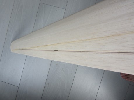

Gradually, I got more familiar with the construction. I noticed that in the design (drawing of the FMT), the fairly thin tail boom was made of balsa wood. A strong nose, large wing and a stabiliser with two fins all connected with a balsa tube, combined with my landings, I was afraid that it would break quite easily. I therefore decided to make four “girders” from glass roving.
Using a specially made sanding block, I sanded four 5 x 1 mm grooves, which was good exercise for my muscles...
Pre-impregnated glass roving (four per groove) were anchored to sturdy points in the fuselage nose

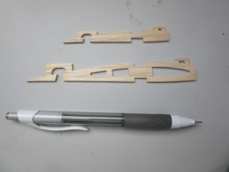

To illustrate this, here is a photo of a some ribs. Just looking at them makes them break... (apparently there was something wrong with these ribs, they were over).

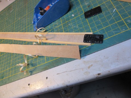

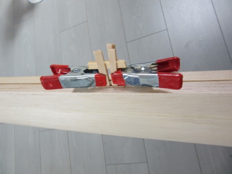

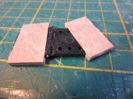

In order to position the hinges properly and easily so they can be glued in later, I made a kind of box out of 0.6 plywood strips with 2X2 slats.
The slats were planed down to the thickness of the hinges

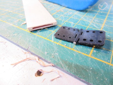

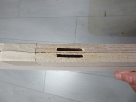

Using a saw blade and sandpaper, I made slotted holes in the front of the aileron.
The plywood glues nicely to the balsa upper sheeting.

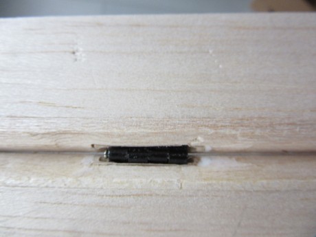

I had to chamfer the opening of the boxes so that the hinge would fit nicely. Fortunately, that worked well, and the aileron fitted nicely, just a very small gap.

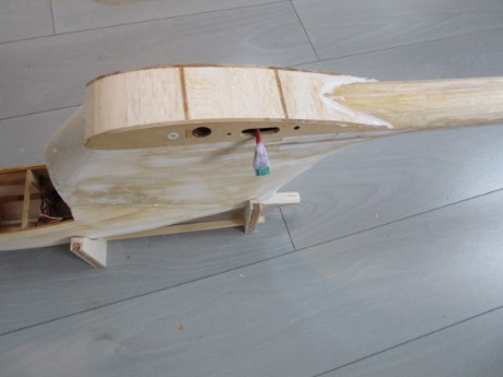

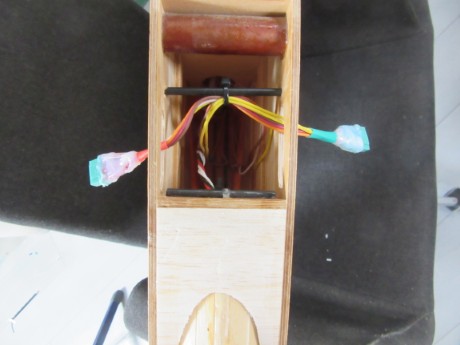

The cable bundles for the wings were not complex, and a 3 mm carbon rod with a tie wrap ensured that the connectorss did not fall into the bottom of the fuselage neck.
Now I could glue the fuselage shut with confidence.
