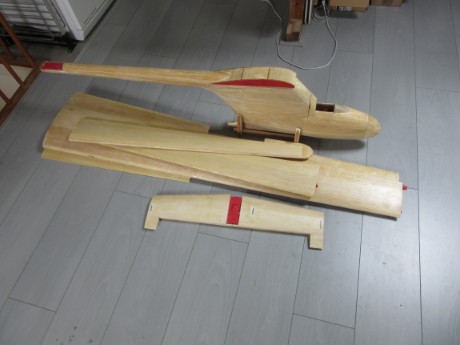

Just under a week ago, I found myself with a three-quarters completed Elefant (Ku4) in my attic. It took a moment to process, something like, what, where, how? But apparently I like that. I found the necessary information on Retroplane, Thomas had posted a beautiful set of photos on Retroplane, I'll include a few.
This (extreme) aircraft hasn't flown much, with a wingspan of 30 metres and weighing just under 500 kg, it's not exactly a handy structure, but that's less of an issue for the model. The Ku 4 or Elefant (it was heavy, big, grey and had two fins) broke up while flying in the clouds (with minimal instruments and virtually no flaps), but the pilot landed safely with a parachute. The plane was completely destroyed, in short, it surely was a daring project.
Then I sat down quietly in front of Raymond's construction, which was very neatly built and surely complicated! The tip ribs are really tiny, compliments to Raymond.
Where to start?

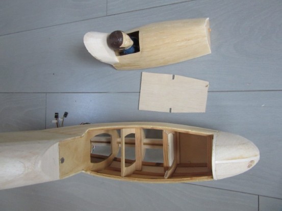

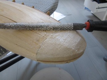

After studying the photos and the FMT drawing (which Raymond included), I first filed the nose cone into shape.
Then the front of the neck; the photos were different from the FMT drawing, so I made it a bit straighter. Inside the fuselage, I made some shelves with space for ballast, the receiver battery and the uncoupler servo.
I also made the core of the skate simple, using 8 mm balsa wood without suspension.
I put in the pilot, he realy had to sit that low.

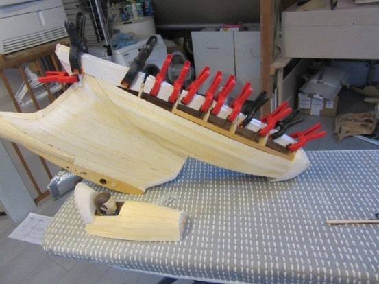

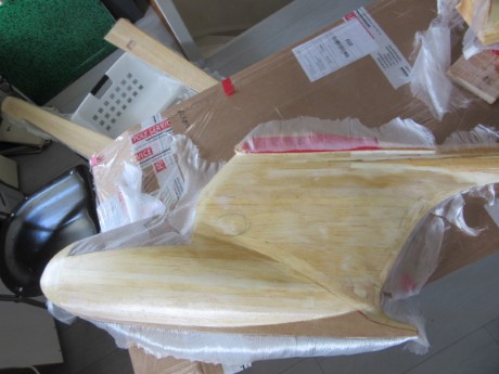

I continued with the nose of the fuselage, glued 0.6 mm plywood on both sides of the skate and the lower planks of the fuselage.
Once the fuselage has been glassed (with 25 gram cloth) the skate itself will be attached.
The horizonral stabiloizer mounting plate with wooden spacers so that the tail will not crackwhen tightening the bolts.

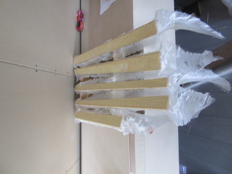

Gradually, I got more familiar with the construction. I noticed that in the design (drawing of the FMT), the fairly thin tail boom was made of balsa wood. A strong nose, large wing and a stabiliser with two fins all connected with a balsa tube, combined with my landings, I was afraid that it would break quite easily. I therefore decided to make four “girders” from glass roving.
Using a specially made sanding block, I sanded four 5 x 1 mm grooves, which was good exercise for my muscles...
Pre-impregnated glass roving (four per groove) were anchored to sturdy points in the fuselage nose
This gave me a bit more peace of mind.
Then the cockpit. The pilot (Kronfeld I presume) could enter through a hatch, when closed only the upper half of his head protruded above the fuselage. The instrument panel is very close!
More nice photos from Thomas article of the Ku4
After the necessary gluing and sanding, this is what it looks like.
I'm leaving the top of the fuselage open for now, so I can still reach it, first to finish the wings with servos.

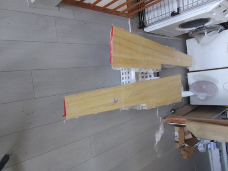

Now that the fuselage was coming along nicely, I decided to start working on the wings.
First of all, I would like to compliment Raymond on how he built the wings and took care of the wiring.
To illustrate this, here is a photo of a some ribs. Just looking at them makes them break... (apparently there was something wrong with these ribs, they were over).

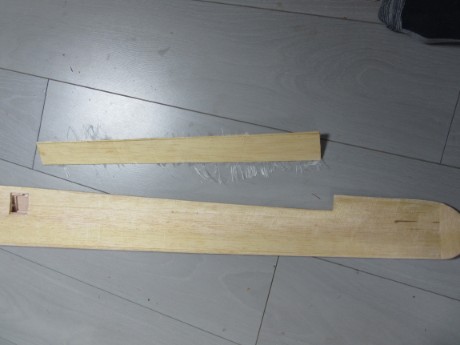

In order to position the hinges properly and easily so they can be glued in later, I made a kind of box out of 0.6 plywood strips with 2X2 slats.
The slats were planed down to the thickness of the hinges
Using a saw blade and sandpaper, I made slotted holes in the front of the aileron.
The plywood glues nicely to the balsa upper sheeting.
I had to chamfer the opening of the boxes so that the hinge would fit nicely. Fortunately, that worked well, and the aileron fitted nicely, just a very small gap.
Then I tested the wiring and cut the already built in spoilers free. They worked perfectly!
The cable bundles for the wings were not complex, and a 3 mm carbon rod with a tie wrap ensured that the connectorss did not fall into the bottom of the fuselage neck.
Now I could glue the fuselage shut with confidence.

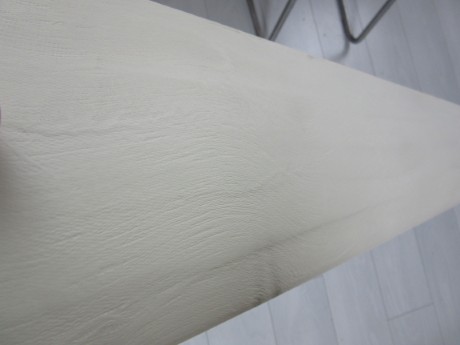

I continued to sheet all the surfaces. I thought if I coated it with glass cloth and epoxy the surface becomes much firmer and it also adds strength. I wanted to keep it light. I ordered 25grams glass cloth and started. First I covered the tail boom with 80 grams of fabric to make the tailboom a bit stronger.
The 25gram cloth turned out to be woven differently than the heavier cloths and it was not easy to laminate it neatly. I hoped that spray putty would make the visible tissue structure disappear, but unfortunately that turned out differently. I then had to fill and sand everything smooth, that was a good arm exercise.... Anyway, the surfaces feel smooth and I hope it will look good after spraying.
In any case, the balsa ailerons have become much more torsionally stiff.

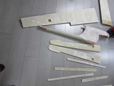

Wih the fins and rudders I had to make a choice. In the FMT drawings, the fins and rudders are flat plates constructed from balsa wood. On the 1:2 model and the original, they are fabric-covered structures
I decided, also in the hope of keeping it lighter, to build them from ribs. That was a challenge for me to draw in Devwing, but I managed it in the end,
Adri milled the ribs and TE in balsa and plywood
I planned to make the front spar from 3mm aluminium tubing, which is easy to bend, but the curved spruce spars were more difficult. I was able to bend them into the right curve using boiling water
and let them dry. To create a hinge, I used 1.5mm epoxy strips with 1.0 mm holes through which a 0.8 mm steel wire through it, so that the rudder remains removable.
The fin is attached to the stabiliser with two nylon M3 bolts, (on the photo they are from steel) removable for transport and so on.
The second rudder went a bit faster.
Both rudders in place,
Raymond built servos into the stabiliser, the control rods come under the stabiliser.
Unfortunately the fin and rudder are not much lighter than the ‘FMT’ rudders, but hopefully it looks better once they are sheeted with diacov and painted.

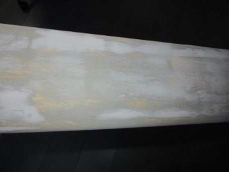

PS : quel enduit tu utilises pour boucher les irrégularités de la structure ?
J'ai un vieux pot d'enduit AXTON light… que je devrais pouvoir ré-activer avec de la colle blanche diluée pour que ça redevienne une "crème" facile à étaler…

The balsa is covered with 25gr/m2 glas fabric & epoxy. Rhat gave a irrigular surface [argh] . I used a filler (enduit) acrylic Rapide from Jansen, which worked very nicely.
