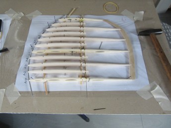

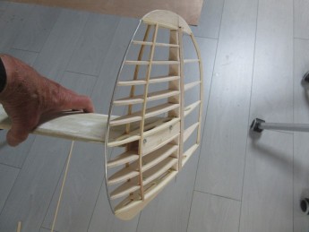

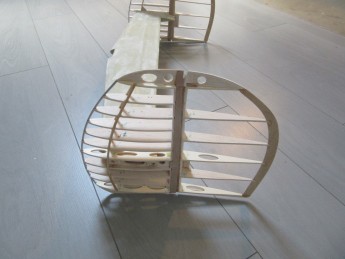

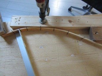

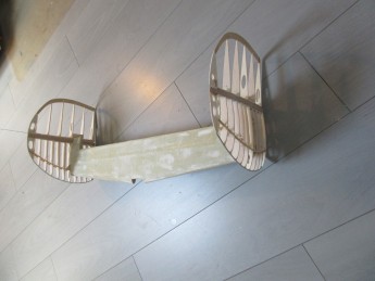

 Posté le: 05/09/2025 11:09    Sujet du message:  |
Wih the fins and rudders I had to make a choice. In the FMT drawings, the fins and rudders are flat plates constructed from balsa wood. On the 1:2 model and the original, they are fabric-covered structures
I decided, also in the hope of keeping it lighter, to build them from ribs. That was a challenge for me to draw in Devwing, but I managed it in the end,

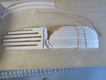

Adri milled the ribs and TE in balsa and plywood
 I planned to make the front spar from 3mm aluminium tubing, which is easy to bend, but the curved spruce spars were more difficult. I was able to bend them into the right curve using boiling water
and let them dry. To create a hinge, I used 1.5mm epoxy strips with 1.0 mm holes through which a 0.8 mm steel wire through it, so that the rudder remains removable.
The fin  is attached to the stabiliser with two nylon M3 bolts, (on the photo they are from steel) removable for transport and so on.
The second rudder went a bit faster.
Both rudders in place,
 Raymond built servos into the stabiliser, the control rods come under the stabiliser.
Unfortunately the fin and rudder are not much lighter than the ‘FMT’ rudders, but hopefully it looks better once they are sheeted with diacov  and painted.
