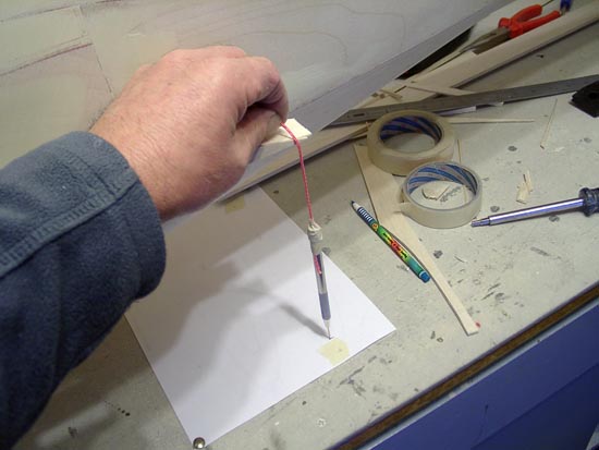

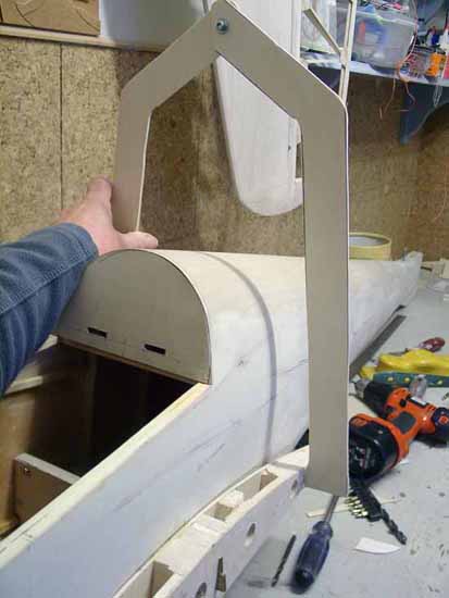

Making up the wing root fairings...
Once on the fuselage, how do we make sure they are parallel to each other?
First I used the old method called the 'drop test'.
Then I used a much simpler method by making up a BIG pair of callipers
Now the fairing is lined with CTP and the rigging angle is checked by means of the incidence gauge

Hi Chris
An observation I often made with the Musger MG19 construction is the wrong angle how the wing root fairings are mounted with regard to the fuselage. If you have a look on a real MG19 you will realize that the angle stays exactly the same as the angle of the wing at that point. Thus if you want to be full-scale you might change it. That was the reason that I have changed the layout of the formers of my 1:4 MG19A construction as you can learn from this subject http://www.retroplane.net/forum/viewtopic.php?t=1742&start=0 or this picture
I Hope you understood what I want to say [humm]
Stephan

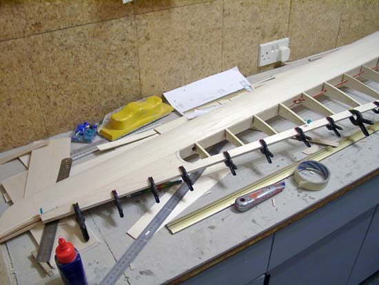

Work commences now on the outer wing panels
Setting up for the joining of the spars. This is where vertically oriented spars are useful, as there is plenty of glueing area for the join...
Now the spars are ready to epoxy together...
Here the spar joint has been reinforced both sides with .75mm CTP...
Now it is starting to look like a proper glider
