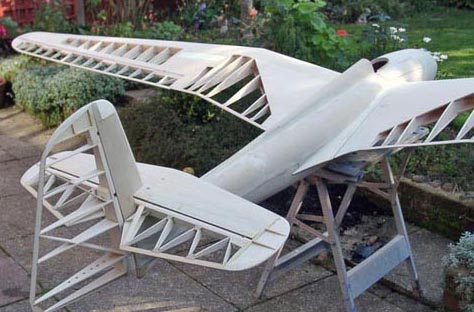

The fuselage is now completely covered. I am realy wondering how you want to realize the wing mount
Stephan |

Stefan, I will probably do something crude, as I did with the Habicht...
It usually works out OK:

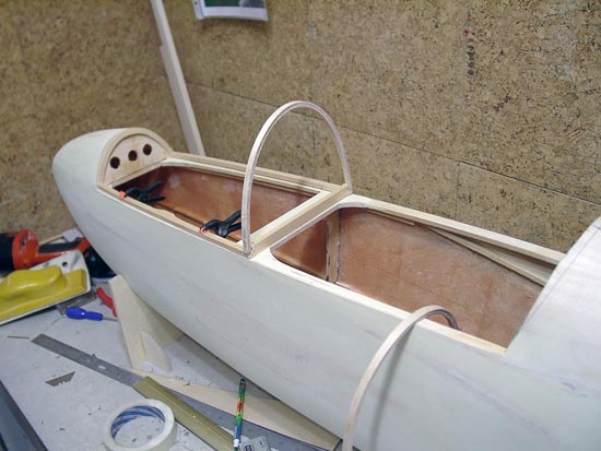

Posté le: 10/12/2008 00:20 Sujet du message: |

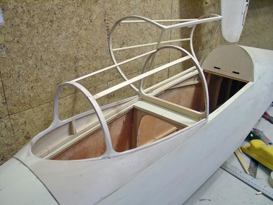

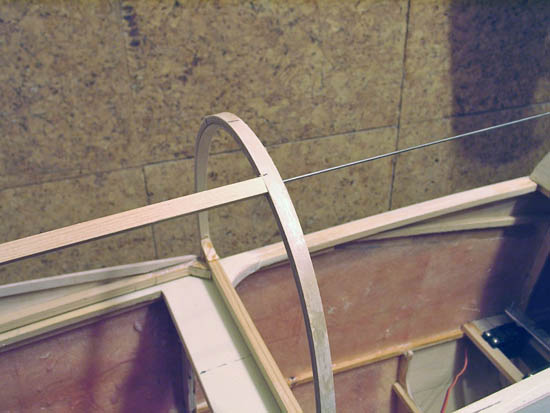

Moving now to the cockpit canopy, first some of the frames are made up from laminations of .75mm CTP
The lower frames are made up from 12 x 6mm spruce. The right hand side one is already hinged up...
 cw |

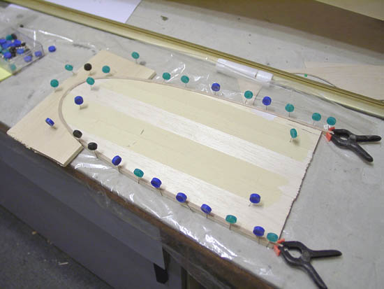

Posté le: 11/12/2008 23:40 Sujet du message: |
Paul, I can't get any either, but it doesn't matter as it's not really necessary. I've been experimenting with these laminated pieces: 5-min epoxy gives a quick and strong job, but there's obviously not much working time. White glue left overnight is easy to use, but the piece is slightly more flexible, but still quite useable..

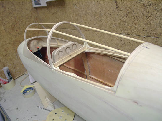

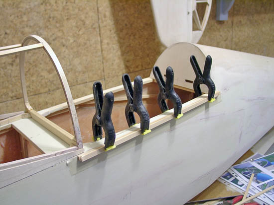

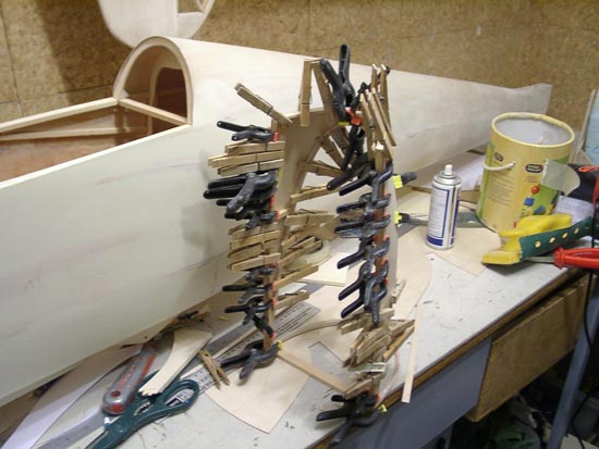

Posté le: 15/12/2008 20:24 Sujet du message: |
Still working on the canopies, but the job is nearly done...
Adding the .75mm CTP to the front canopy
The joins are reinforced with piano wire pegs
[img]

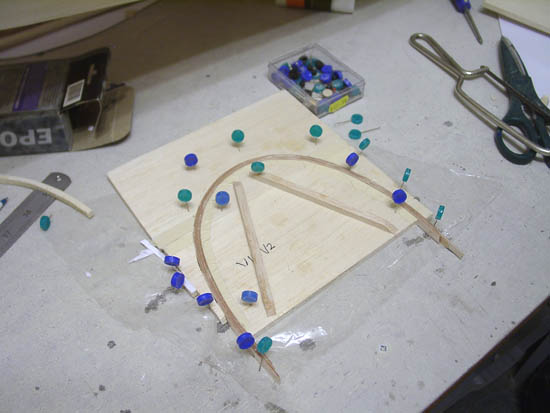

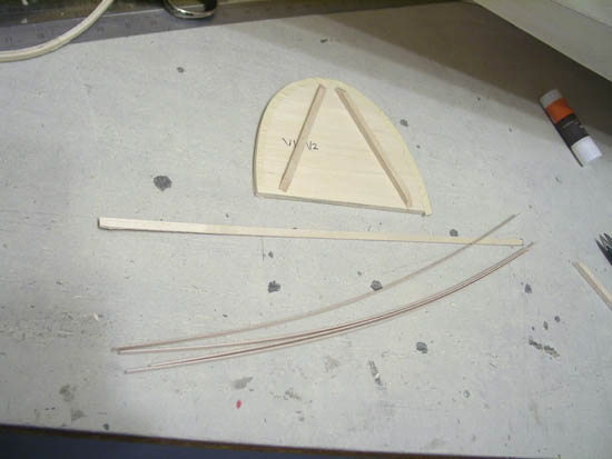

The lower frames for the rear canopy are shaped to the fuselage by clamping 2 laminations of 6 x 3mm spruce epoxied together
Now the job...
is nearly complete...

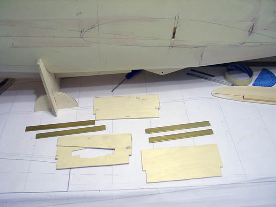

Posté le: 20/12/2008 19:03 Sujet du message: |

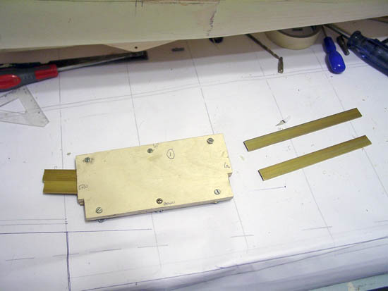

OK, for Stephan, it's time to look at the mounting of the wings
Here are the component parts of the wing joiner box...(The brass box-tubes cross over in the main box to allow for a greater depth of joiner blade)
The sides of the box are bolted together to allow the brass boxes to be inserted through the fuselage sides afterwards...
The box is now in the fuselage, but will not be permanently fixed until the wings are properly set up...

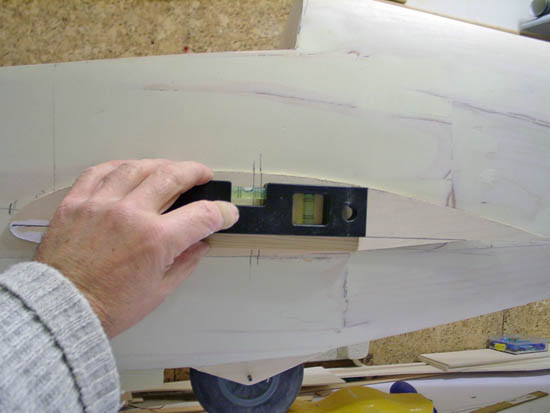

Posté le: 21/12/2008 18:02 Sujet du message: |

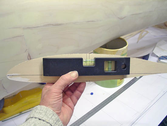

Now to set the angle of the wing root fairing...(I should have done this before the last post!) A wing profile blank has been cut out and a piece of 6 x 6mm spruce glued to the geometric chord line.
The fuselage has been set up so that the tailplane is at 1.5 degrees negative. Now the profile blank is set to zero with the spirit level and the position of the wing root fairing established...
The aerodynamics are:
HQ35/14 wing root, HQ35/13 at the gull join, and HQ35/12 at the tip.
The calage is 1.5 degrees
 cw |

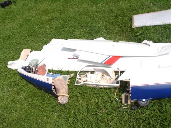

Posté le: 24/12/2008 00:37 Sujet du message: |
In the UK Ramin comes in 2.5m lengths, ideal for wing spars. However, the quality has become not so good in the past few years, and here is what happened to my Skylark 4 on it's 1st flight.
Now I use Spruce, which comes in 1.25m lengths and I now have to splice 2 pieces together to make the wing spars...
 cw |

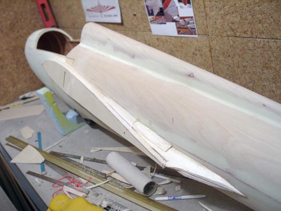

Making up the wing root fairings...
Once on the fuselage, how do we make sure they are parallel to each other?
First I used the old method called the 'drop test'.
Then I used a much simpler method by making up a BIG pair of callipers
Now the fairing is lined with CTP and the rigging angle is checked by means of the incidence gauge
 cw |
