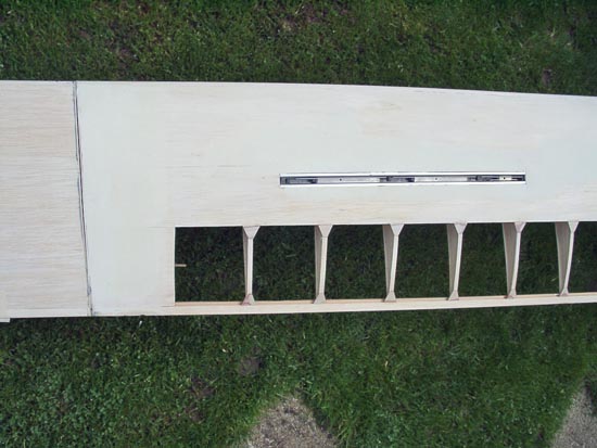

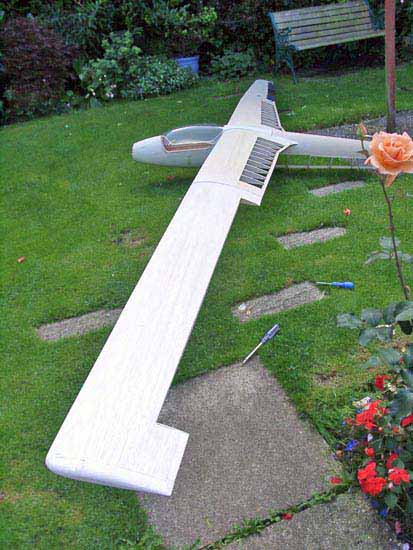

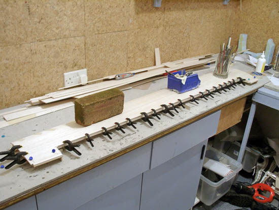

The wing is now laid on the supports and weighed down after taping the upper sheeting into place...
Time to rig again...
Well, we are catching up now: this was only five weeks ago... (I remember it well, it stopped raining for 5 whole minutes) Laughing
cw
Âge: 66 Cancer
MessagePosté le: 21/08/2008 03:41    Sujet du message: Répondre en citant
Chris,
The grass is perfect...... MDR the glider is beautifull too Wink
If I am not wrong, you use red brick as weight during the sheeting. Do you dismantle your workshop [humm] .
BTW congratulations for this professional building [clap] eager to follow it on this forum.

No Pat, I dismantle my neighbour's house Laughing

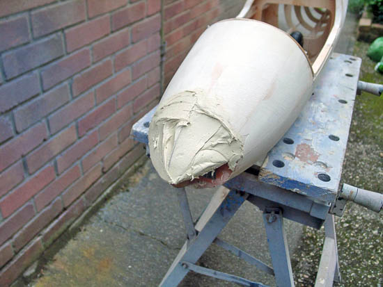

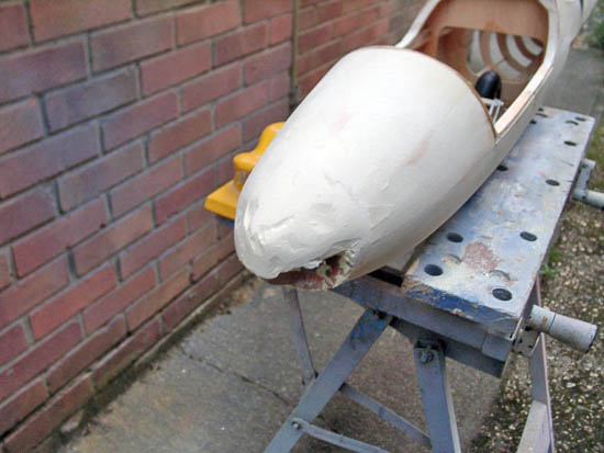

Attention now moves to the front of the fuselage, where it is always best to get some lead as far forward as possible...
Now we return once more to the car body filler...
We use a bit at a time as it can get very hot...!
Almost there...
All we need now is to make a hole for the brass tube that will connect to the tow release...

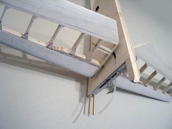

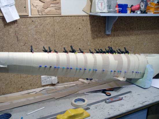

Where the .75mm plywood joins on the fuselage there must be some 3mm sq spruce strip to spread the load. The slots are cut with 3 blades taped together on the hacksaw...
Time now to attend to some of the electrical jobs inside the fuselage...
Now some more plywood can be added to one side...

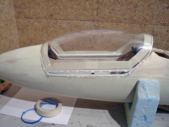

Attention now moves to the canopy...
Cutting it roughly to size. (The canopy is from my Skylark 4 mould which has fitted many models: 2-32, Minimoa, Skylark 4, Dart small & large etc)
Lining tape is used to mark out where to cut. The rule is: 'cut little and often!'
Pacer canopy glue is used to glue the canopy to the frame. Good stuff, dries out to be practically invisible
Now it is all taped down to be left overnight to dry

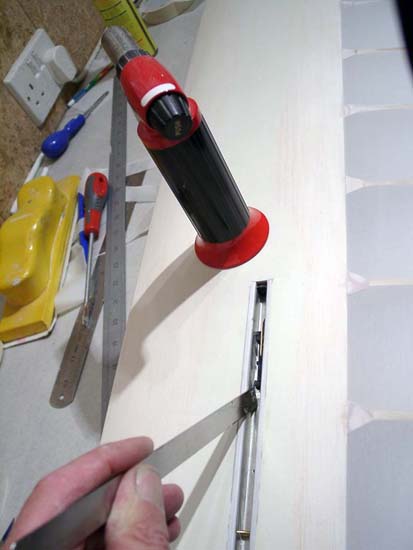

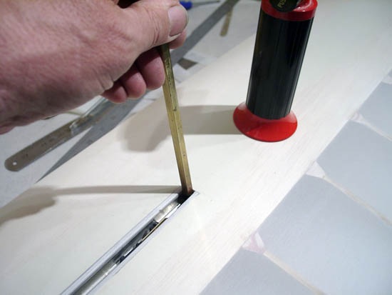

The airbrakes are of commercial design and have been recessed into the wing so that they are flush to the surface. To iron the Solartex into the openings, a piece of wing joiner bar is heated up with a gas torch and used to iron the 'Tex into place...
For the ends, a piece of square brass tube does the same job...
