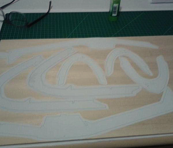

MessagePosté le: 23/11/2018 00:29    Sujet du message: Répondre en citant
I started to cut the plywood parts with a blade, but it's too heavy for my elbow. I will borrow a jigsaw tool from a friend of mine. Regret to not use the laser cut... at least for the ply parts.

Until now, I have cutted all CTP parts of the fuselage, but 3 of them I will have to repeat cause they broked. Not easy to cut some parts.

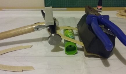

MessagePosté le: 04/12/2018 23:02    Sujet du message: Répondre en citant
A stubbord N1 requires a high skill to shape.

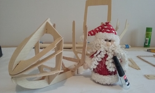

MessagePosté le: 29/12/2018 20:44    Sujet du message: Répondre en citant
Those reindeer went out for a strike....mmmmmmm..... having some ideas for the next Christmas
