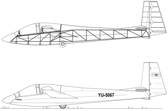

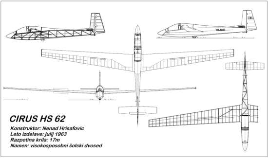

These days I start to do a research about vintage Yugoslav bi-place school sailplane CIRUS HS 62, as I feel it would be a very good candidate for an large scale RC model, due its proportions and unique appearance.
The main problem at most of old Yugoslav sailplanes is lack of technical documentation. There are some pretty weel done drawings in Martin Simmons books, but there are not all interesting sailplanes included.
For a CIRUS HS 62 (and later model 64), only some 3 view drawings are widely available for public. As I see, these drawings are not well acurate drawn that could serve as a firm base for making the scale rc model plans&drawings.
So, my research lead me trough a very comherensive site of Aeroclub Sarajevo, where an excelent description of complete design story of CIRUS HS 62 and 63, are made by its designer, Mr. Neno Hrisafovic.
I was able to contact Mr. Hrisafovic regarding Cirus saiplane and he kindly give me his hand in order to help me with research of this cute sailplane details. In lack of workshop technical documentation, he send me some hand made drawings of internal structures, and give me some explanations. At this moment only minor details are waiting to be made and or corrected, but there are pretty enough informations now, for making of plans and drawings of a scale RC glider.
I am aiming towards 1:4 scale, which gives a wingspan of 4,25m.

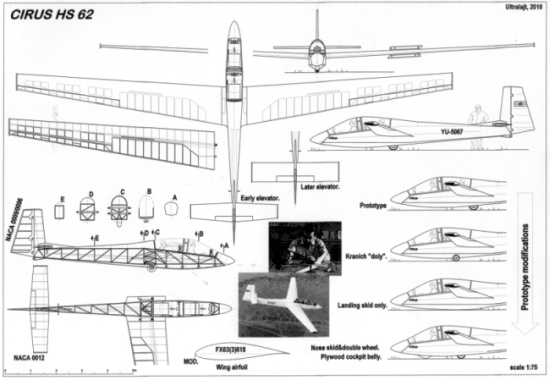

Well, enough talking, let see the drawings I made:
If you want to see larger resolution of this drawing, and some other photos of this sailplane, visit my web Blog here (scroll down to Cirus):
http://ultralajt.webs.com/apps/blog/show/5309098-triglav-and-cirus-hs-62-vintage-yugoslav-sailplanes

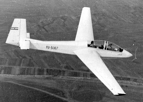

Some of the photos of a Cirus as found on AK Sarajevo website.
CIRUS HS 62 prototype during a test flight.

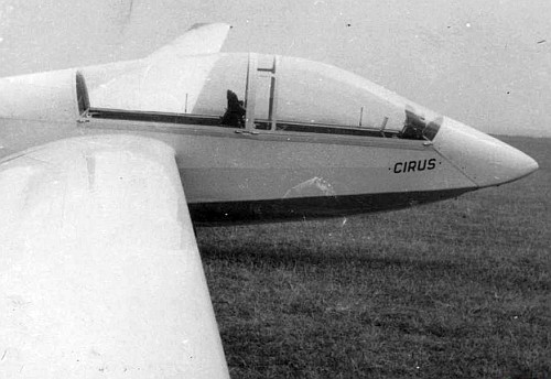

Very eye apealing canopy.

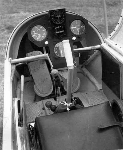

Front cockpit.

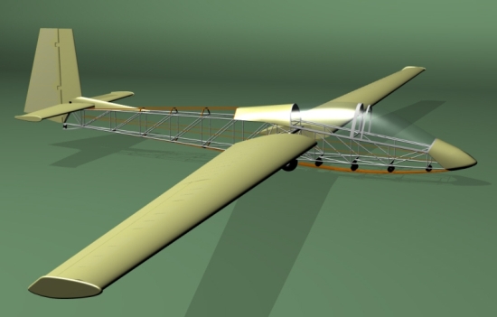

And another view on my drawings:
Never try, never fail....

Yes, the shape of the fuselage is very odd and not similar to any school biplace sailplane of same era and made with same construvtion method (welded steel tubes). I think it will be a "crowd pleaser" at our aerotow meetings, next year if I manage to build it.
Now, I am already completing my "research" and CIRUS HS 62 drawings. As you can see from the drawing below, the prototype sailplane went trough some modifications, that lead later to HS 64, that was made all from wood. If I ever build this sailplane as an RC model, it will be the very first version of prototype.
Mitja

Hi Mitja, you want to build the fuselage in welded steel tubes?
ultralajt
Inscrit le: 01 Nov 2007
Âge: 65 Sagittaire
MessagePosté le: 28/11/2010 18:46    Sujet du message: Répondre en citant
This is the drawing of construction of real sailplane. It was welded steel tubes design.
I am very much tempted to use similar technique for my model.
I did not decided yet if will be steel or aluminum.
It was done both materials on RC models well, yes?
Mitja

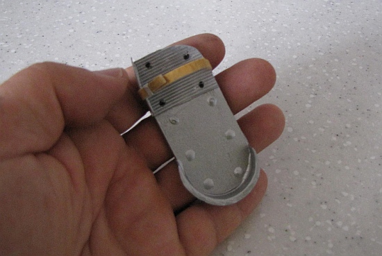

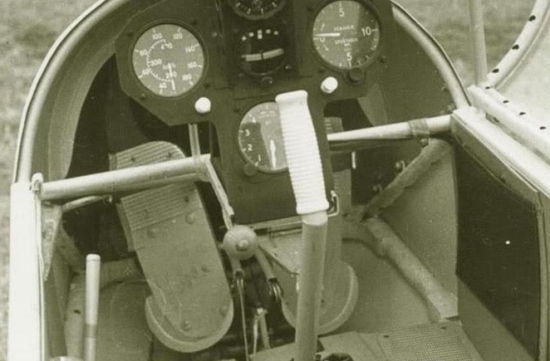

Bytheway, I want to share here a little trick I use in making scale rudder pedal for the Cirus HS-62!
I was having troubles finding some useful material to represent rubber padding on the rudder pedal (see photo below).
Suddenly I came acros idea, that save me from headache! [tips]
I take Super Sculpey* (polimer clay for making dolls and sculptures) squeeze it into a thin sheet (pancake) and then use threaded rod ( M8 ) and roll it over the Sculpey surface. Threaded rod left nice grooves into the Sculpey.
Then I put Sculpey into a kitchen owen for 30min at 130°C. Sculpy then became hard. It can be cut with scisors and sand with sandpaper. It behave then like an ordinary plastic. I glue a part of that material onto the pedal and paint with silver paint.
I am sure, that any complicated part of the cockpit interior, like various buttons, knobs, handles and paddings, can be done using this material.
See my finished rudder pedal:
* Super Sculpey
It is modeling clay, also useful for making pilot heads, hands, shoes....
Link: http://www.sculpey.com/products/clays/super-sculpey
Regards!
Mitja
MessagePosté le: 03/09/2012 14:06    Sujet du message: Répondre en citant
Very realistic, good idea ! Very Happy
MessagePosté le: 03/09/2012 20:21    Sujet du message: Répondre en citant
Nice detail [clap] I like too super sculpey, it's a good idea to use this product for that
