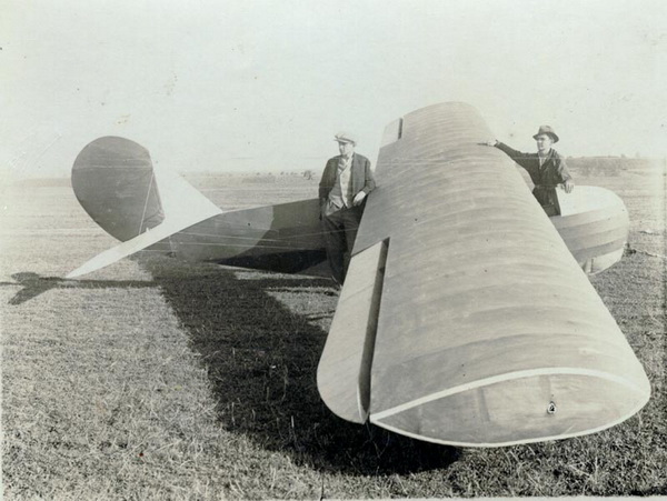

In the photo above is Mead Challenger glider that was built in 1931 by Jean Barboi in Romania with blueprints brought from USA. This is pretty much all i know about this glider.

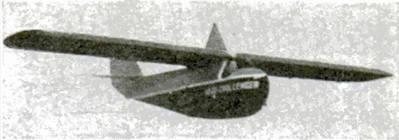

Another photo with Mead Challenger built in Romania:

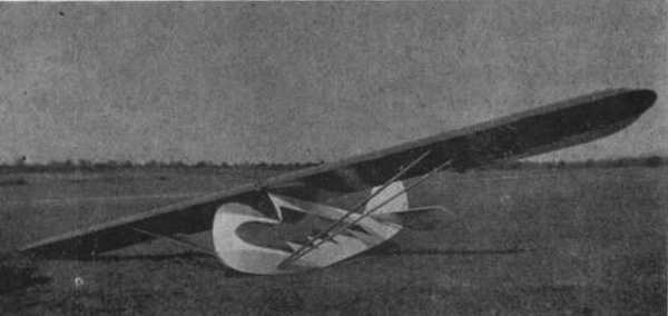

Mead Challenger with kingpost:

Obviously gliders with kingpost are equipped with so called "Flying wires"(lower fuselage to wing) and "Landing wires" (kingpost to wing).
"Kingpostless" version is equipped with solid wing struts.
Version with kingpost usually weight less, but have larger air drag and time consuming rigging-assembly, while version with struts has larger weight, but less air drag and simplier assembly at field.
