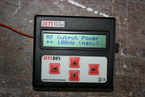

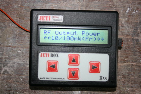

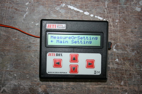

Good morning Wolfgang,
For to modify for French area:
whith Jetibox look at the picture:
Good luck for double click, it's not easy Rolling Eyes

Hello Jean Claude
Yesterday I have testet the Jeti Duplex Modul.I have two and the one of September has the french mode (the older one must be updated ) and it ist easy to change into the french mode because the double click is not a double click but a long push-thank you for your photos of the Jeti box.So eyerthing is ok with my MX 22 Jeti for France next year.
