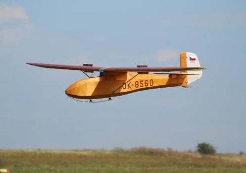

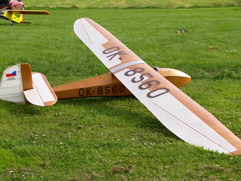

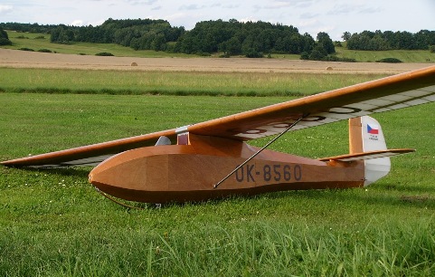

Zdravim / Hello
I congratulate to Laurent, very nice Krajanek !
I would like to present pictures of my "Krajanek"
Scale is 1:3, cover is plywood and cloth "Koveral"
Bye
Robert
