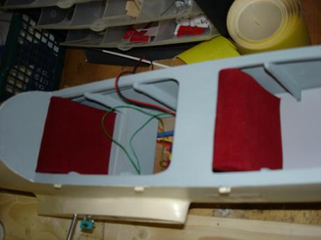

Posté le: 01/06/2007 18:14 Sujet du message: |
...my fuselage ist finished. All in all im satisfied for this first all wooden Oldtimer...but...at the retroplane meeting I will not allow anyone to come nearer than 2m to my MG19...
For me the cabin was the most difficult part. Maybe I try to make a cabin with brass tubes after this season.

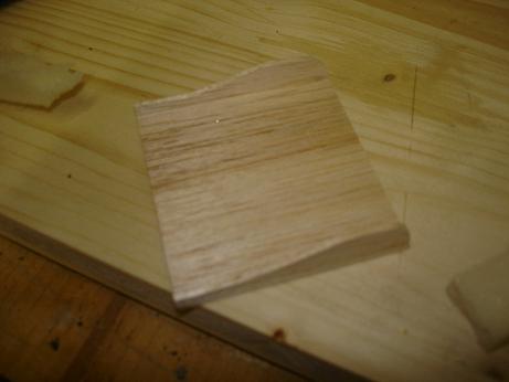

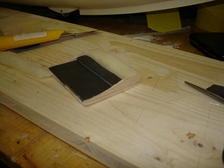

Today i made the last details:
the metal cover of the skid:
and the covering of elevator and fuselage
