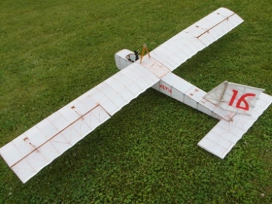

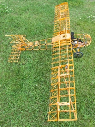

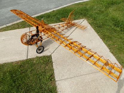

Hi, Gents,
i have almost completed the glider.
see the thread and a small movey.
http://forum.rcdesign.ru/f82/thread339159.html
http://www.youtube.com/watch?v=loRGoF3a5Ww&feature=em-upload_owner
Nikolay

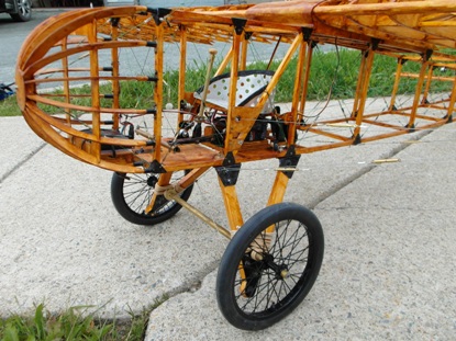

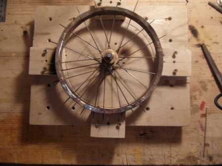

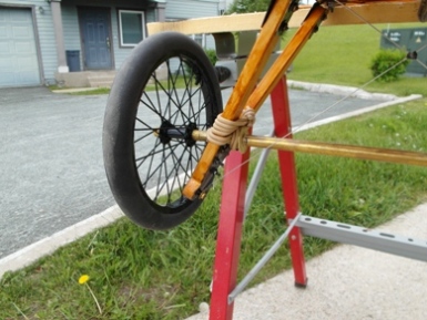

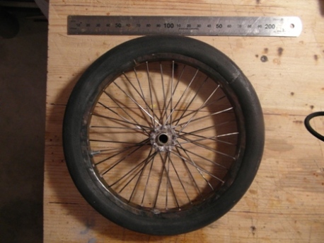

MessagePosté le: 01/07/2014 07:57    Sujet du message: Répondre en citant

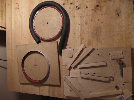

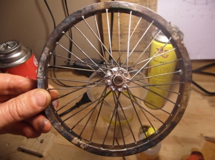

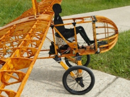

Hi Nikolay, congratulation, beautiful work, all these détails are for me the most pleasant, especially the spoked wheels. I don't see on the photos, how you made the rims? like me, in steel? or in brass?

Vincent,
I wanted to place the photos, but I struggled with the requirements to reduce photos to 100 kb and 600x600. Why not to make it automatically in your site:-).

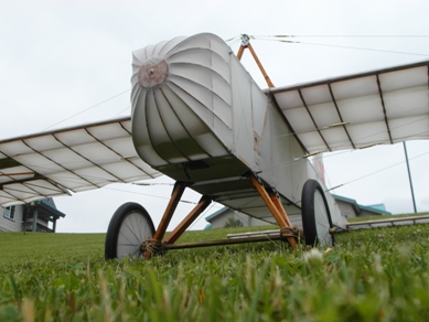

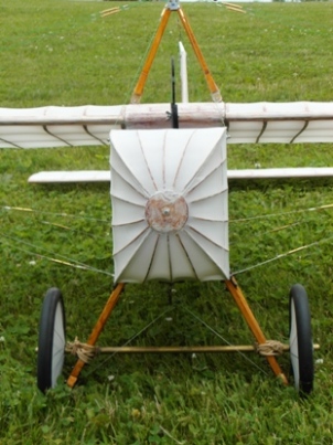

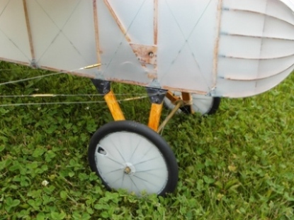

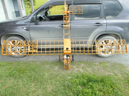

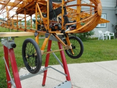

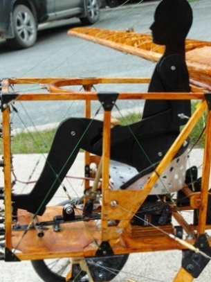

MessagePosté le: 01/07/2014 14:04    Sujet du message: Répondre en citant
Vincent,

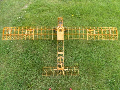

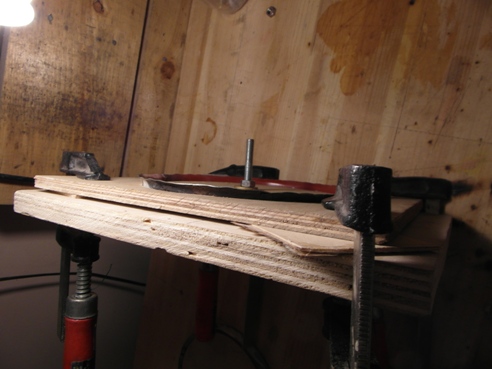

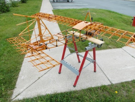

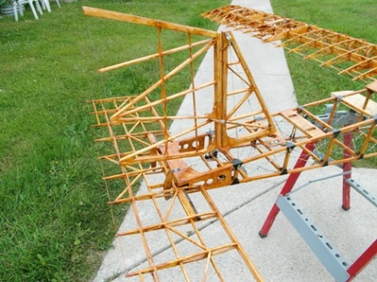

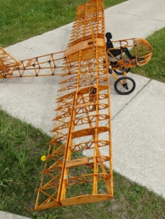

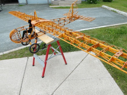

Some photos attached below. The wheels I did by the same method as you did, but I did not use hard-soldering because hard-solder temperature soften the spokes. But if we use a soft-soldering the original strength of the spokes remain the same as no effect of high temperature.
Actually to design and construct this model for me was a big challenge but the major job is done and I have to cover the model only.
I will post the pictures of covering process later, say end of July as now I am going to vacation, have some rest.
To be continued

MessagePosté le: 31/07/2014 13:50    Sujet du message: Répondre en citant

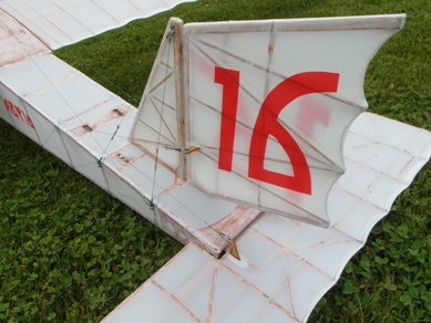

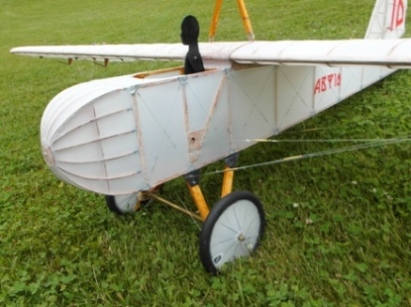

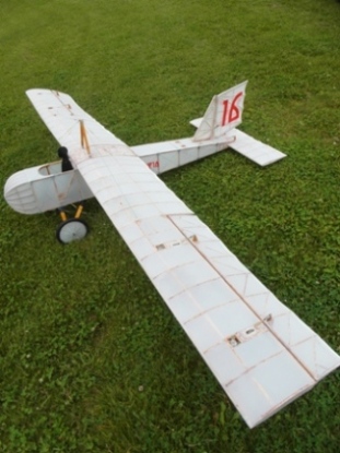

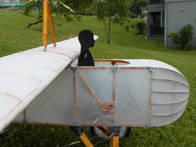

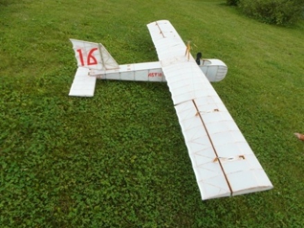

Gents,

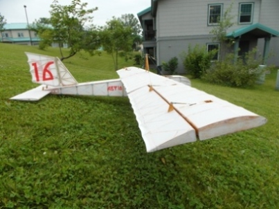

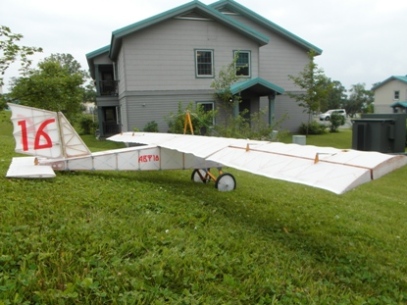

So, I completed the glider. Everything is done. The flying weight is around 4800 gr. Charged wing area 46 gr/sq dc. Wing span 3 meters.
Some weight left for balance, but it is almost 30% of the cord (365 mm).
Soon I will try to launch the glider by bungee start. I am afraid to launch it, I spent around one year to build it, so if it crashes, it will be a sad day for me.
In any case I will try to launch it.
P.S. It is my first experience to use Diacov tissue, it is very good and light for application tissue with good adhesion and shrinkage properties.

MessagePosté le: 31/07/2014 14:08    Sujet du message: Répondre en citant
Congratulation Niikolay, the covering is clean [clap]
would you aging the Diacov with wood tint?
Nikolay Lebedev
Inscrit le: 30 Oct 2013
Localisation: Yuzhno-Sakhalinsk
Âge: 52 Cancer
MessagePosté le: 31/07/2014 14:19    Sujet du message: Répondre en citant
Yes, Vincent, I used one layer of wood tint, and nothing more. It seems to me that it is enough.
I would not say that the covering I did quite clean and perfect, it is my first experience with Diacov and if I knew its shrinkage capacity I would reinforce some parts of wing and make them stronger. But I did what I could with my relatively small experience in model making process.
