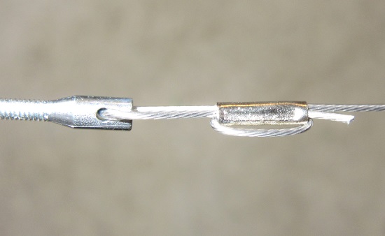

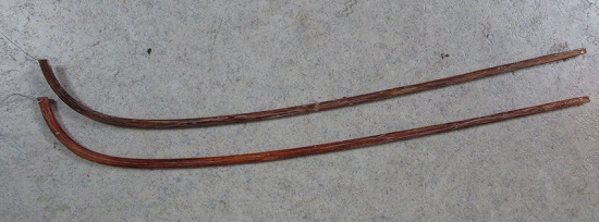

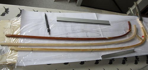

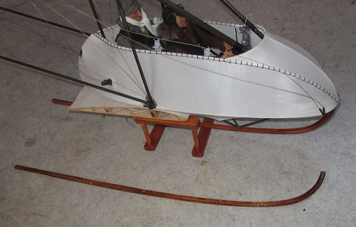

The first thing I had to tackle was the rigging. I ordered wire for 90 kg, but it was to thick, not good for the looks Sad . The insufficient clamping in the bushes with the 40 kg wire was the problem, the wire just slipped out. I think this was a mistake of mine. I am familiar with sailing and on sailing rigging the clamping is 100% free of slipping, so I just clamped the bushes. Now I learned to make an extra loop in the wire to get it slip free.
I replaced all the rigging, except for the rudder controls, because the loads are so much less.

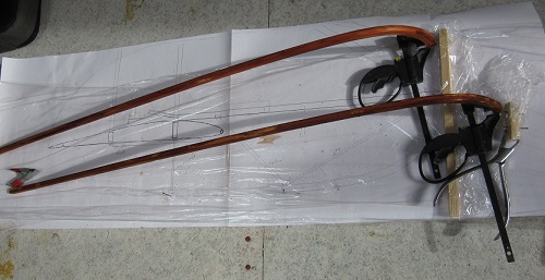

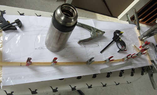

Next was a new skid and I decided, (because its an vulnarable and essential part) to make a spare one.
laminating with thin CA, the thermos bottle is to keep the water for bending nice hot.
coloured with bister and merisier from "Liberon"
On top, bottom and sides I put glass roving with epoxy.
Connected with 3 M2 bolts to the fuselage

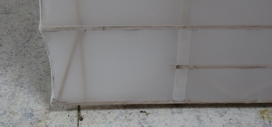

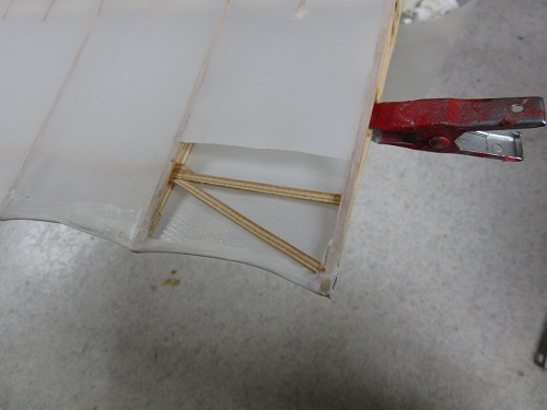

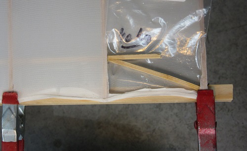

Finally I repaired the wing
So the Fokker is ready to fly again, we are going to tow it, hopefully coming weekend, the forecast is good Very Happy and Rob is getting his Piper ready.
Vincent

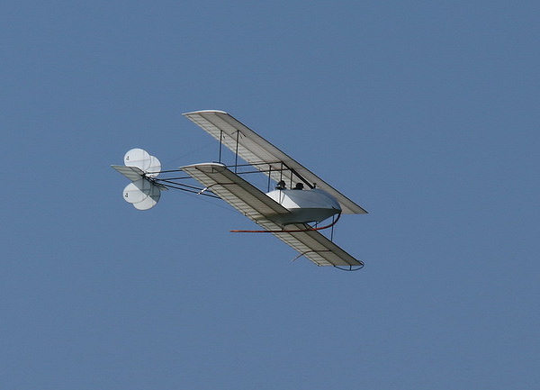

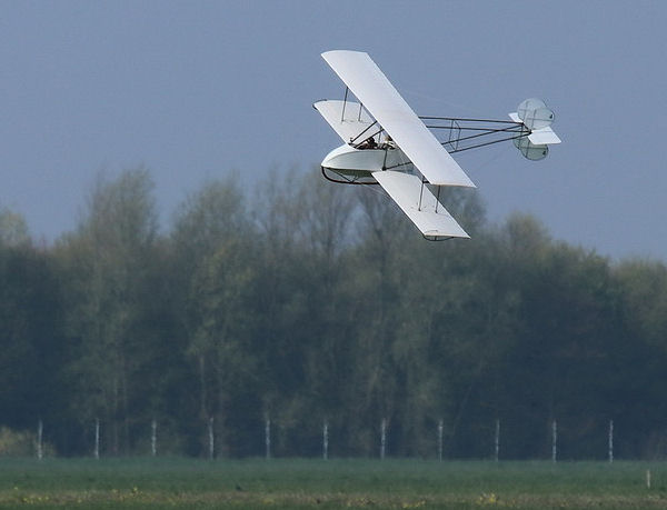

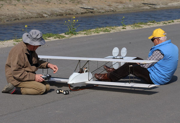

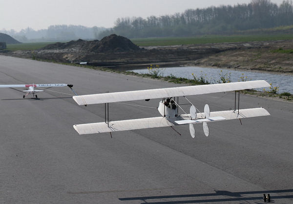

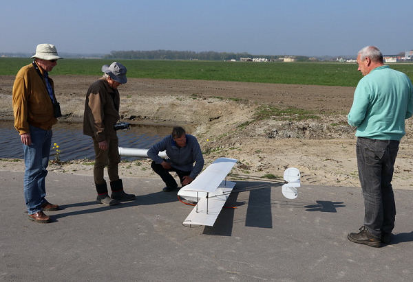

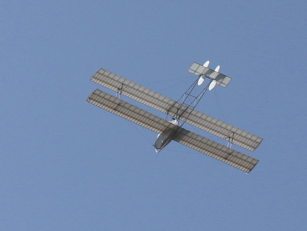

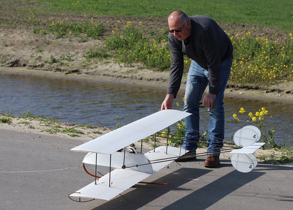

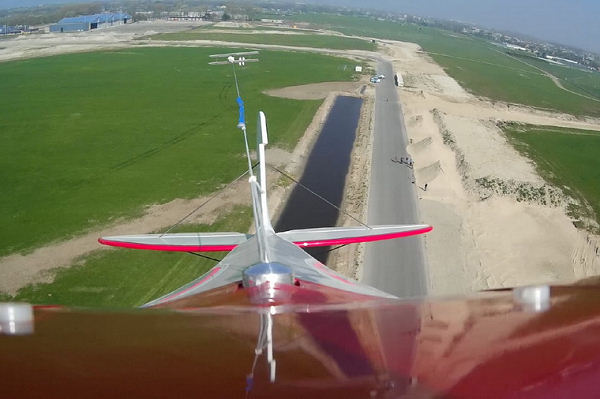

I have had the honour of witnessing the first flights of the Fokker yesterday. It was beautiful!
I't up to Vincent to tell his story, but here are the pictures and movie:
The plane had a lot of attention.
Some adjustments
Ready for takeoff
The sunlight throught the ribs is beautiful.
Vincent was a happy man!
Celebration with some eclair-like cakes.
And a special car-sticker was made.
Movie of the first flying day.
https://www.youtube.com/watch?v=bNBfcjasQuk
I have not been able to fully enjoy the view of this magnificent plane, because I've been looking at it only through my various cameras, but the resulting photos and video make up a lot for that.

Thanks very much for making this wunderful film and the also the pictures [clap] [clap] [clap]
I am very glad the FG-2 flew, still some work on it, we think th c.g. is too for in front ( it flew with about 10 degrees elevator up)
But it flew! Very Happy and the anemometer really turns Very Happy
Vincent
