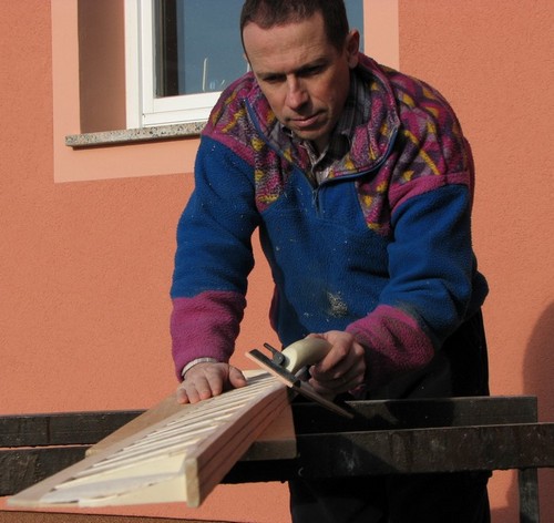

Today, the weather was good for filling & sanding...
First, some lead in the front...(The planking is left un-trimmed to give the filler something to grip on to)
A piece of flexible CTP is ideal for smoothing the filler down to make it follow the curve of the fuselage...
Uros, a very dusty business Very Happy
There it is, about four hours' work. That's it for this year, see you in 2011...

Nouveau messagePosté le: 31/12/2010 20:04    Sujet du message: Répondre en citant
[humm] almost forgot the fuselage... Glad to see that I am not the only one sanding outside at 2 degrees below [grrr] ...
Regards !
Uroš
