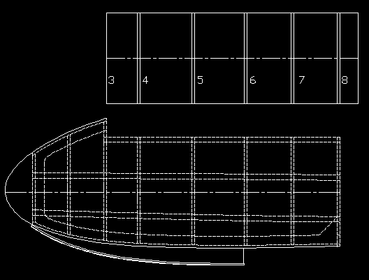

For the moment I have already cutted out the fuselage formers and the first doubt arrived: on the building manual it is said that the front part of the fuse must be built upside down, over a 15mm template that simulates the cockpit surface... well, is there any template of that piece? on the plan I cannot find it.
Any clue will be highly appreciate.

Hello Daniel, welcome on the forum Very Happy
it's not on the plan, because it's easy to draw it
enclosed the dxf file, if you prefere a pdf file to print, I can make it

Thanks Vincent, it is very clear. No need .pdf. I'll be posting some pictures as soon as I start glueing.
